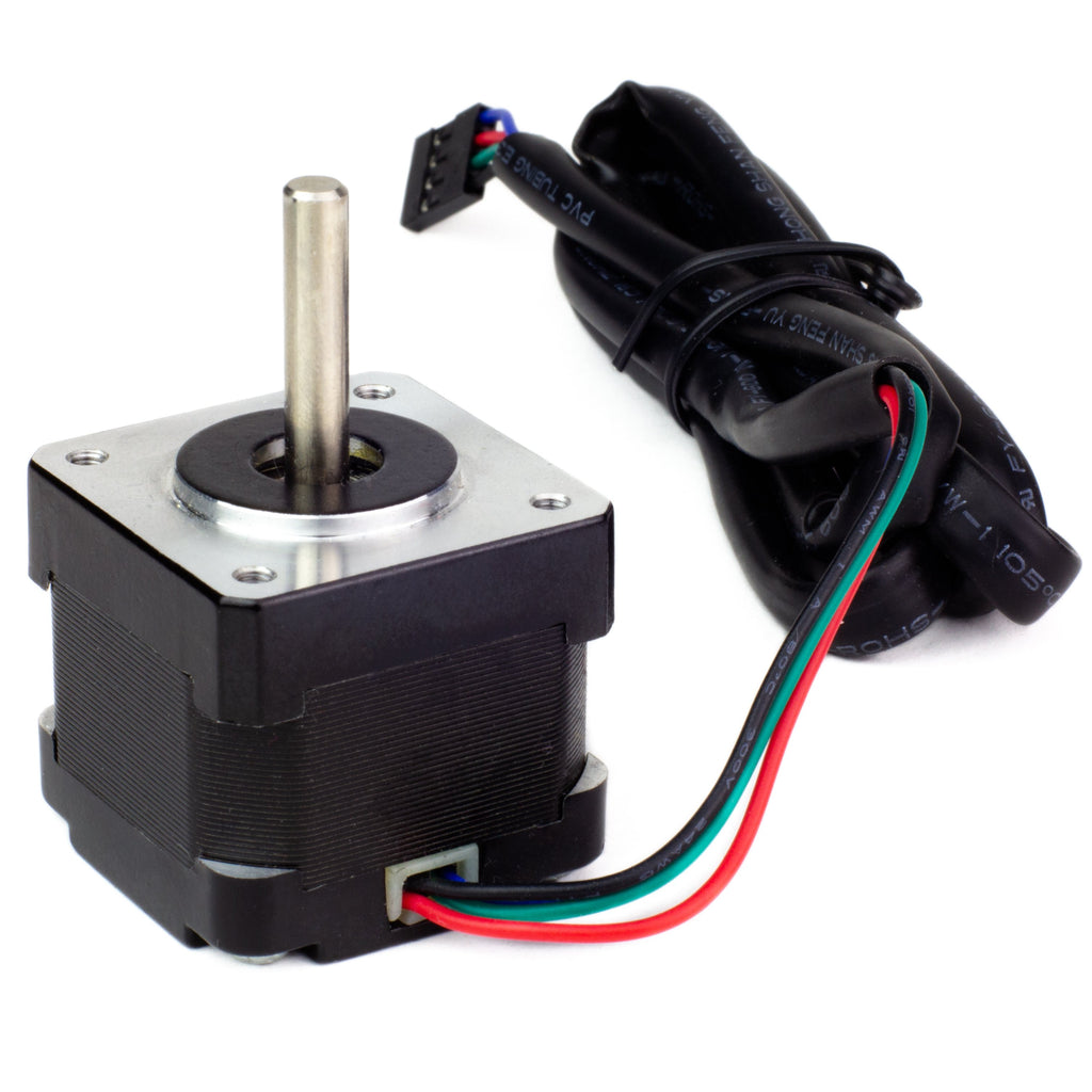

The three sizes of NEMA stepper motors here—NEMA 14, 17, and 23—refer to the size of the motor and hence the amount of torque that the motor is capable of; the larger the motor, the more torque (specific torque values are in the tables below).
Please note: while the NEMA 14 and 17 come with detachable cables terminating in female headers, the cable on the NEMA 23 is non-detachable and terminates in bare wires.

For the NEMA 14 and 17 stepper motors, the red (+) and blue (-) wires control bipolar driver A and the green (+) and black (-) bipolar driver B.
For the NEMA 23 stepper motor, the red (+) and green (-) wires control bipolar driver A and the yellow (+) and blue (-) wires control bipolar driver B.
